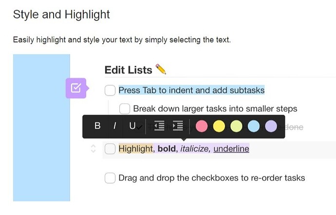

Yes, @Steven_Jackson, I am hoping, too. For me as visual person is to mark text or font in different colors a great help!! Taskade (www.taskade.com) does in this way:
