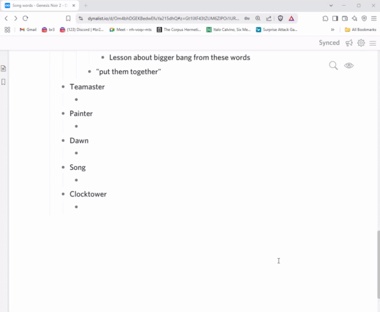

It only happened just now, I don’t know how to make it always happen.
At the end of my document are two items. The last item is empty.
I have the cursor at the second last item, and I type cursor-down. The document scrolls so the last item is not visible. This also happens if I mouse-click the text area of the last item.
My only option from here is either to blindly type, or use the scrollbar to put this back on-screen.
This seems not to happen if the last item is not empty.
This happened before the latest update. I updated to the latest. It still happens.
Okay, so I scrolled way down so there’s a lot of blank space visible at the bottom. Each time I type cursor-up cursor-down, the document scrolls about 2 or 3 lines so the text is closer to the bottom.

I don’t have this problem in my whole document, just parts of it. Very strange! Would appreciate any help.
Here’s a video of the error
I’ve just started having this problem as well. Whenever I press ā€œenterā€ the page scrolls up. Seems like a new regression, though it’s unlikely anything has changed with Dynalist since it’s not actively worked on so maybe a change in Chrome that’s causing compatibility issues.
