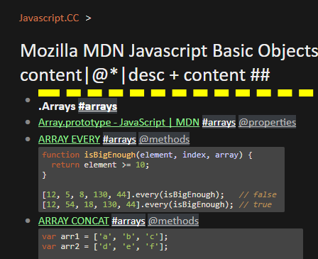

I use 2 styles for the following reasons:
I usually have a very well-lit office environment so it makes sense for all my regular notes to have a white default theme so it makes transitioning from dynalist notes → web surfing extremely easy for me
However, when I write code (javascript, CSS, PHP, etc) i usually use the same styles as code IDE editors like sublime text, visual code studio, atom.io , etc
I keep all of my heavy code snippets using the DARK THEME indicated above
This way I have both a default theme, and dark themes on demand
This helps me differentiate different documents in dynalist and helps me stay organized
When I take coursenotes though with code snippets, I usually use a default theme though

Tag colors look like this:
Not much to say here, except I have some specific targeters
Explanation of CSS in there
a[href^="https://developer.mozilla.org/"] {
color:lightgreen;
This makes anything with that URL have a special color, since I reference javascript libraries alot. You can modfiy the URL towhatever you want , like youtube, etc
a[title^="Filter #"] {
color: #ffffff;
font-style: normal;
This makes “#” tags in dynalist with a specific color override on my regular theme
